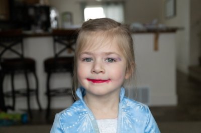

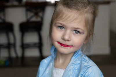

    Thank you everyone for responding. I finally was able to do some example shots. These are both shot at f 4.5, 1/500, iso 2000. The first is with my nifty 50 and the second with the 24-70 f4 and are SOOC except I did enable profile corrections in LR on both. I focused in my daughters left eye for both images. 682E3696-9BF0-4F65-BABC-708C6839DF46.jpeg

    Thank you everyone for responding. I finally was able to do some example shots. These are both shot at f 4.5, 1/500, iso 2000. The first is the my nifty 50 and the second with the 24-70 f4. View attachment 11449

    What focal length did you shoot with when using the 24-70?

    It was at 50mm also.

    I can't really see much difference with the images that you have posted. I am not doubting you as once you have resized the images for the forum, the difference may not that easy to see. I don't own either of the lenses that you are using. So I went searching on the net and I had a look at the lab tests that have been done on both lenses. And indeed, the 50mm f1.8 prime is sharper than the L lens at f4.5. I was a little shocked to be honest with you. But that is what the test results are showing.
    I can't really advise you what to do with the 24-70 f4. I know if it was myself, I would not be that happy with it, and I would look at exchanging it for another model of Canon lens, or getting a refund. Yes, it is a more flexable lens than the prime, but if it is not showing you the sharpness you are looking for...........

    The problem with these images is that they are too small to evaluate sharpness. They need to be at least 2000-3000 pixels wide to be of any use. Could you please upload larger images?
