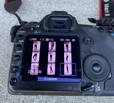

    Canon 5d mkii
    The zoom controls on my 5d mkii doesn’t seem to be working, really hoping it’s user error. I can zoom out to see 9 images on the display but I’m unable to get back to viewing a single image. Reset to factory settings and still can’t see anything but 9 images. Can anyone help?

    So the magnifying plus button (far right) does not zoom back into the selected image? That's how it should work.

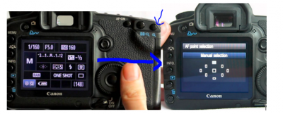

    Does pressing the same button while shooting go from the display on the left to AF point selection screen on the right?
    If not my initial guess is that button may have died.
