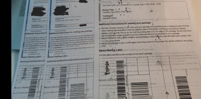

    I have a ImageClass LBP621CW - a year old (warranty expired last week), now having problems with printing. I have tried all sorts of cleaning via the printer maintenance menu but the problem still persists. I don't even know how to explain what's being printed so i have attached a picture.
    Since it's out of warranty, just to have the tech come and look is 1/3 of the printer price. Did anyone experience this issue before? Would you mind giving me some suggestion on fixing this?
    Thank you!!!

    sounds like the fixing assembly may need multiple cleans? https://oip.manual.canon/USRMA-3625-zz-SSS-660-enUV/contents/devu-mainte-clean-fixa_clean.html
    Haven't seen this not be resolved by cleaning.
