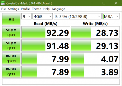

    Hey i've been frustrated with my cannon 600d lately, it always pop out a message along the lines of Recording has been stop automatically. Currently I'm using a kingston canvas select plus 32gb u1 micro sd card using a converter to put on my camera. I've tested the speed using crystaldiskmark 8 and it show consistent 28-29 mb/s writing speeds and 90ish mb/s. I was recordig in 1080p 24fps with the standard bitrate and im not recording in raw. I tried to downsample the footage from 16mp to 8mp it lasted longer but still stop during the 13-16 minute mark. It wouldn't be a problem if i could continue recording after that but it just records for like 1-2 minutes and then the message would pop up again. I tried letting it cool off for 5 mins, change the adapter and nothing works. I was considering getting a u3 class card since it can record up to 4k so it should leave me some buffer room but that would be my last option. If it's worth anything i was recording at 30 shutter speed, 4.0 apperature dan 800 iso. Please help me i'm new and i'm frustrated. If u didn't understand something from my description just ask, sorry if it's not clear english is not my first languge. Thankyou for reading this and please help me.

    Veredaux, welcome to the forum, this sounds like the same problem I have with my 60D. From what I have read and seen on youtube, this is done so the sensor does not over heat. This gives a limited recording time. When I am recording, I constantly have to hit the record button and patch it all together in photoshop.

    My understanding is they use a 4gig clip size to stop from overheating. The DSLR is more compact and as large high performance sensor, its going to run hotter in a tighter space than a designated video camera. The storage speed is going to have very little to do with the fact that the sensor is running very hot recording a constant 20-30 min clip of video. I know even the ehigher end still cameras have 30min limits that people have mentioned.
