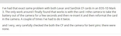

  4. porkphoto
    918
  5. Craig Sherriff
    thanks for that I shall give it a try, The CF cards are not new, this could be adding to the problem also.

  7. porkphoto
    918
    Sorry to hear that, all the other posts leads to a bent pin in the CF card slot, that would be an ouch and a trip to the Canon repair shop.
