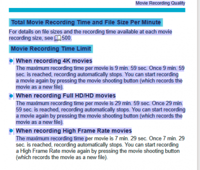

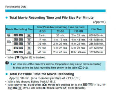

    Mentions of recording video in the manual and limitations, nothing specifically calling out streaming video straight from camera...
    I would caution doing much longer than when you get a over heating warning. Canon will likely not cover any damage you made by running the sensor past the indicated warning to the point of damage. It is a large powerful sensor in a very small frame. I only made the point that this is a camera, not a webcam by design. Any manufacturer will pivot to the needs of customers, these mid level cameras have become very popular for vlogging so I guess I can see why company's created such kits to help them sell.
