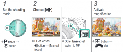

    Well canon cameras by default will not trip the shutter unless it can obtain focus in both A+ and manual picture modes, with the M50 i believe there is the ability to toggle between auto and manual focus on the back dial of the camera which should release the camera from searching for focus before allowing the shutter to be tripped. This is made easier on the DSLR as the lens notifies the camera it is in manual focus. For lenses with a switch on them you still have to select the MF option.
    For the lens adapter canon's adapter extends the wiring so it should work for focus as will as aperture as far as I know for the 70-300 EF. If you have a non-electronic adapter you will have to go into the custom function menu and enable the camera shutter to fire with no lens attached.

    Thanks very much for the reply. yep the conversion adaptor does not seem to have any wires or contact. - I could not find the custom function menu , but I did press the MF/AF function button on the back of the camera to the right of the screen and indeed with its own supplied lens and with the lens cap on it would fire then. However with this DSLR zoom lens and its adaptor , same thing again I could not get the shutter to fire at all even when I press the AF/MF button at the back of the camera

    With your manual adapter the camera thinks there is not a lens attached ...so it will not fire the shutter.
    You need to find the custom function menu I have mentioned. Seems from what I can tell pressing the middle Q setting button and hitting ok, it appears it is on the 5th tab of function settings. See this page for instructions https://asia.canon/en/support/8203864100 You should be able to find any special settings you need through googling for them.

    Thank you johnsey - I managed to find the custom menu and the 'release shutter always' setting - and there's the other oddity I find (maybe its not?) but 'Custom Menu' only shows up on the display in PASM modes - which is why I could not find it when the dial on the top was set to Auto mode. also now have found out that even though I set the shutter to execute always in custom menu , even if I then switch to auto mode it will not take a photo with no lens attached or lens adaptor fitted.
    So anyway , got to reside the fact that because the lens adaptor is not wired or has any contacts on it I can only use PASM with the zoom lens on it - but at least it will now take a photo with that lens adaptor on so thanks for pointing that information out about changing the setting in the custom menu.
