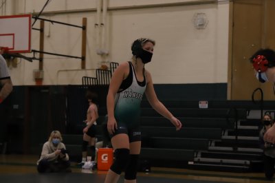

    Hey folks, so an issue has sprung up over the last two shoots I've done:
    • the image looks darker
    • it looks darker both on the LCD and through the view finder
    • it happened both with OCF with a Profoto transmitter and in natural lighting conditions
    • settings DID NOT change - they were: 1/400; f5.6; ISO 5000
    The camera & lens:
    • 6d mkii
    • Sigma 70-200mm 2.8
    Please refer to the reference images to see what I mean: all three images were shot at the exact same settings.
    Am wondering if it's an issue with the shutter getting stuck halfway through its action... is that a thing? I've heard of the shutter on DSLRs getting stuck in the closed position, so am just wondering if it could be that...
    Any help or insights would be appreciated.

    Are we positive settings did not change? Can you share the matching metadata in screen captures to confirm?
    One thing I am noticing is the darker two have sharp people and bleachers in the background. While the focus point looks to have shifted, it also at first glance seems you have stopped down a few stops and increased your depth of field, that would have darkened the image if the others did not change. Again this is a very quick look at what seems to be happening. That would have caused me to check my metadata on the raw image.

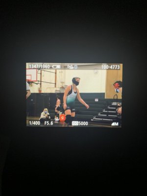

    Thx johnsey - absolutely positive settings didn't change. Here's the series of photos on the back of the LCD which shows that:

    Ok so the back of the camera is brighter than the JPG, the jpg looks like multiple steps of aperture different (including increased depth of field,) despite the camera saying it was set to 5.6.
    My assessment without much tinkering with the gear is that the aperture is getting stuck. If you press the DOF button on the camera, it will show the shutter stopped down in the viewfinder, the fact this is happening without pushing the button and seems to be stopping down further than it is set implies a lens issue. I would see if other lenses behave the same. I would think it is a lens malfunction..
