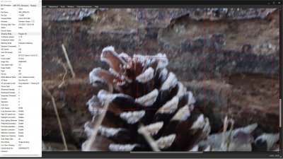

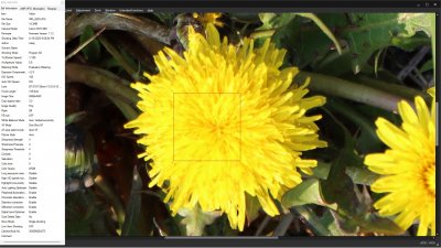

    Hi,
    I'm just a begginer in photography so I'm not sure whether this is the problem of my technique, the problem of my lenses or whether this is not problem at all (and i'm just pixel peeper).
    Lot of my photos are not sharp enough I would say. Some are though but not all of them. I've tried few things:
    • Few ways how to hold the camera to prevent shaking
    • Stabilizer ON and OFF (it's supposed to be 4-step IS). Without stabilizer it's usually worse, but it's too 'soft' even with stabilization
    • Live view vs viewfinder - viewfinder is usually worse
    • Aperture - aperture around 8 is better, but still not that sharp i would expect
    • AF microadjusetements - subjectively it's maybe better, hard to tell.
    • AF method - spot, 1-point, expand, zone...
    I'm using EOS 90D with the kit lenses "EF-S 18-135 IS USM". This lenses have great reviews and are said to be sharp enough. But then it's much cheaper than "EF-S 17-55 f/2.8" or "Sigma 18-35 F/1.8" not to speak about L series. So my question is:
    Is this normal for this type of lenses? Would better one render sharper images?
    Is it just my? But I tried 70-200L IS USM II and i could make better images with that (professional) glass.
    Or is it supposed to be sharper (1/100 with 4-step IS should be sharp even hand holded) and I should take the lenses to the retailer to check?
    I have original jpegs and raw files but i'm posting just the screenshots from the Canon's Digital Photo Profesional with the AF points displayed (red rectangle), 100% size (so only the 'center' part where the focus was) and with the info on the left. If needed I can post original images.
    Thanks,
    3,300

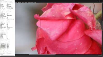

    Matej, looking at your images I see the ones that are using shutter speeds of 1/15th, 1/20th, 1/30th are too slow for hand held images. the image of the rose may be too close to the subject o get sharp focus.
    I suggest you use a minium of 1/60th of a second for hand held shots or a good tripod at these low shutter speeds, image stabalization will only help so much.
    Sometimes at very low shutter speeds, the image stabalization causes blurring it self so turn it off.
    With the rose shot step back and refocus there is a limit to how close you can get with out the use of macro filters. all the best with it and above all keep trying.
    your images will improve.

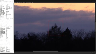

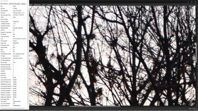

    One of the issues that you have going on here is camera shake. If you look at the last image of the pine cone, in the background, you can see the moment in the stones as a blurring from roughly 1 to 7 o'clock. This is the direction the camera has moved while the shutter is open. What I would suggest is a faster shutter speed. This can be achieved by increasing the ISO that you are using. In a shaded scene like this, try ISO 800, or even ISO 1600.
    The same thing is going on in the third and fourth images as well. I would again suggest increasing the ISO that you are using as the light levels fall.
    Let us know how you get on.

    Ok so I took a bunch of photos outside with higher shutter speeds (1/200, 1/320) and with smaller aperture (7 or 8) and much higher ISO. Now the pictures looks much more sharp even without IS.
