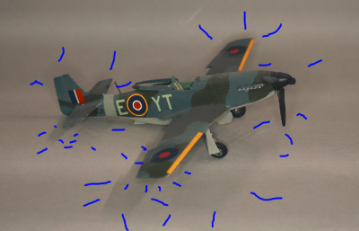

    Here is one extracted from a focus stack. You can see the banding. The background is actually a sheet of grey card.

    Does not appear to be interference being picked up by the sensor, the primary issue I see is there are from what it looks like to me 3 lighting sources, one from left, right, i assume your ring flash head on pointed at the subject you can see a shadow s going in 3 directions and the lighting from the side and above mixed with the ring flash is likely creating the banding on the paper, are you using a shoftbox or any sort of diffusion to eliminate much of these lighting affects? Make sure to shut off the rest of the lighting and only use what you intend to light with and control in the scene, multiple light sources will only cause issues.
    Soft box and turning up the exposure will get you 90% of the way there, your ring flash is not even high enough on exposure to soften the shadows from the other lighting sources.

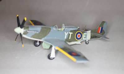

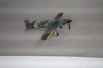

    I tried again with only the ring flash and still got banding. I was happy with the existing lighting using the four LED strips but they didn't give me any light on the front of the models. hence the ring flash. Maybe I should just go to a standard flash gun with, maybe, a filter on the head?

    David, your ring flash is a single source light, being in a ring I think produces the shadow effect you are experiencing, now if you were to place some curtain material around the flash ( leaving a hole in the center for the lens to see through) or something similar, this would create a multi light source or in layman's terms a much softer light thus removing the harsh shadow which create the banding. another way would be to attach a piece of thin whit paper in the shape of a donuts over the flash, you would still get the lighting effect, hopefully with out the banding, again this would produce a multi point light source.

    However, when filming a video I get quite distinct banding that flickers in the video.
