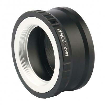

    If it is an M42 screw mount then this is the adapter, i use quite a few M42 and other vintage lenses on the M50, my stand out ones so far are the 55mm takuma ƒ1.8 and the pentacon 50mm ƒ1.8, i also have lome of the longer takumas too all my vintage ones are primes though
    there are quite alot of vintage lenses that can be used with mirrorless cameras, ebay is a good place to get the adapters
