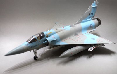

    I should mention that I use the set up for photographing scale plastic models. I attach a typical example. The models are in a light box and are typically 6 - 10" long. I use a Manfrotto tripod. This means that the setup is pretty static and consistent from day to day. I take up to 6 images with the focus in various places and use Focus Stacker to put them all together. The lighting in the box is on the roof and the sides. I need something that gives me better exposure to the front, hence the ring flash. Should I be switching to manual and fiddling around to get the exposure right? I thought that TTL exposure would allow for the flash automatically.
