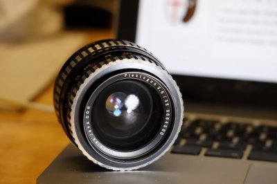

  13. Caladina
    1,865
    i have a carl zeiss jena ddr flektogon 2.8 35mm and an eos m - m42 adapter i also have an ef - m42
    so far neither adapter has given me any sort of image
    the eos m - m42 has a flange to flange of 27mm , i have also tried a whole load of extension tubes for m including sitting the lens on the m50 mount,
    does anyone know if this lens can be paired with a canon M camera
    or could i just have a dud lens , it does have some marks on the assembly slots so it has been opened at some point.
    does any one know the correct distance to sensor of the lens? or where to find it
    Thanks
  14. GDN
    2,213
    45.46mm.

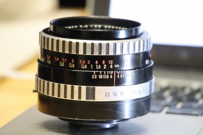

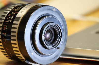

  18. Caladina
    1,865
    i have used fully manual lenses so i have the fire without lens on
    the problem with this lens is the image is just a blur of light, no real image to see, i'm thinking that it might have been opened up and resembled wrong or an element might be missing, not sure. i have another 42 lens on the way so i'm waiting to see what happens with that.
    the aperture blades seem to be working fine.
  19. Caladina
    1,865
    craig do you have a pic of the rear end of your lens, just want to see if mine looks the same where the rear element is.
  20. GDN
    2,213
    On the second image, does the infinity symbol line up with the infinity mark? Or does it stop before or past it?
