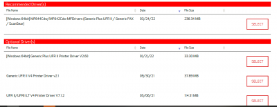

    My work computer does not have a dvd drive. I downloaded the putative drivers. MF642CMFDriverV6404WP.exe
    I AM an administrator on this computer. I select "run as administrator." It prompts me for type of connection and gives only two choices: USB or network. (I want Wi Fi). I select network as the closest match. It tells me: "You do not have sufficient privileges to install the program. Log on again with administrator privileges." I DID logon with such privileges and selected "run as administrator." I have never encountered such an error on any other software I have installed. Please help. Is there a different driver for installing for wi fi? BTW, the printer was ON.
