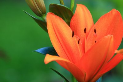

    I had a chat with Canon last night and they had me send them an image showing my problem. They replied that the settings I used with gray, did not hold and that I should go ahead and use a sheet of white copier paper. To which I did. I will post the result of capturing one of the Maroon, (dried out) flowers and later will post an image of the Day Lily taken with the 80D also. IMG_3049.JPG
    Much more accurate result. :)
  4. Tonytee
    Unfortunately, I am not out of the woods quite yet. The following image is of a flower whose real color is a deep,dark red. I will be receiving
    a new gray card this coming Monday and will see how things go from there. Many, many thanks to all of you awesome folks for the many useful and educational hints and suggestions. Cheers. Tony IMG_3051.JPG

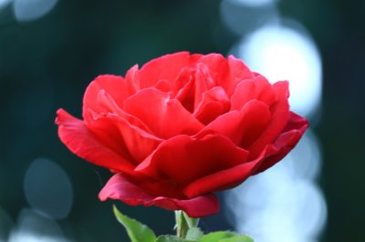

    Okay, here is an image that has the color that I have been chasing. Or, better yet, kicking a dead horse. I went ahead and followed your instructions, i,e, got out of Creative Mode and left it in Neutral. Then I checked White Balance by shooting other colors and they turned out fine. Only difference was that I started shooting with White Balance in Daylight mode and that really helped a lot. Next, I made the switch from JPEG to RAW and Man o' Man am I glad you recommended that change. Next I closed the built-in flash and started to manipulate the camera's settings i,e., TV 125, AP F/11 and left ISO Auto right there and it did use the highest setting available at 6400. Again, this image is the result of the changes and I am a happy camper so I will not have to send the gear to Canon Service Center. Let me know what your opinion, please. Again, many thanks for your time and efforts. :)) IMG_0079.JPG Resizing is the only adjustment I made in Photo Editing Software. Cheers, TT

    This is the actual color of the subject. After trying everything I could think of and failing, (The subject consistently turned out a bright red) I then got into the Creative Mode and tried one feature I had not used and that was: "Faithful." I also tried this feature on other flowers and the colors came through as very true and accurate. This was taken with my Canon EOS 7D Mk II with Canon EF-S 55~250mm, IS, STM lens. Unfortunately, the Gray Card does not seem to work very well with my gear. Thanks again for all of your help. Tony :)
